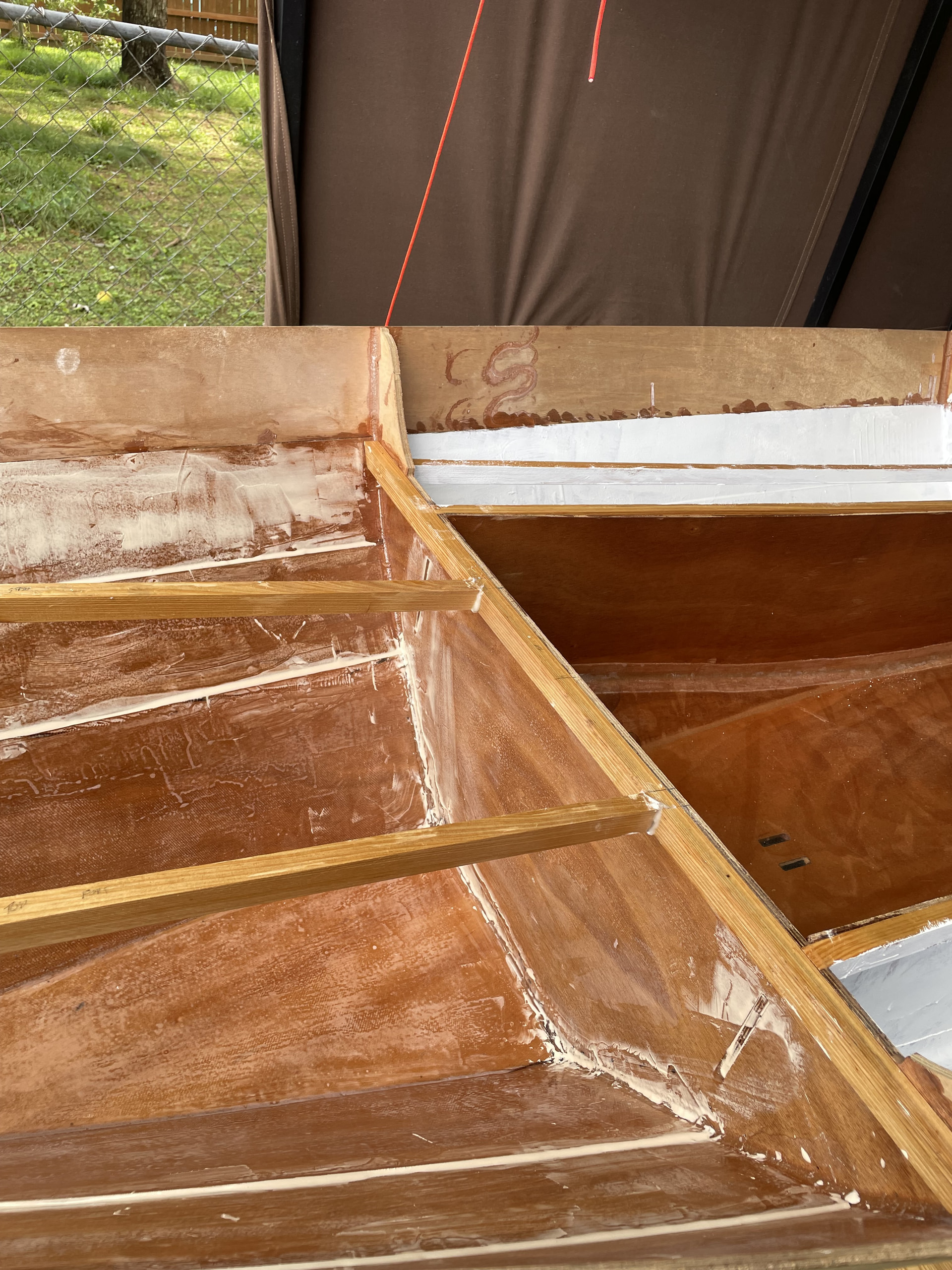

Micro Balloons in the forward compartment. This one had a lot of epoxy and glass issues to remediate before I could fair it. Loose glass at the fringe mostly but also a big gob of fillet had come through the mortise and tenon joint. Half an hour of chiseling, rasping, sanding, and swearing and it became something like passable.
