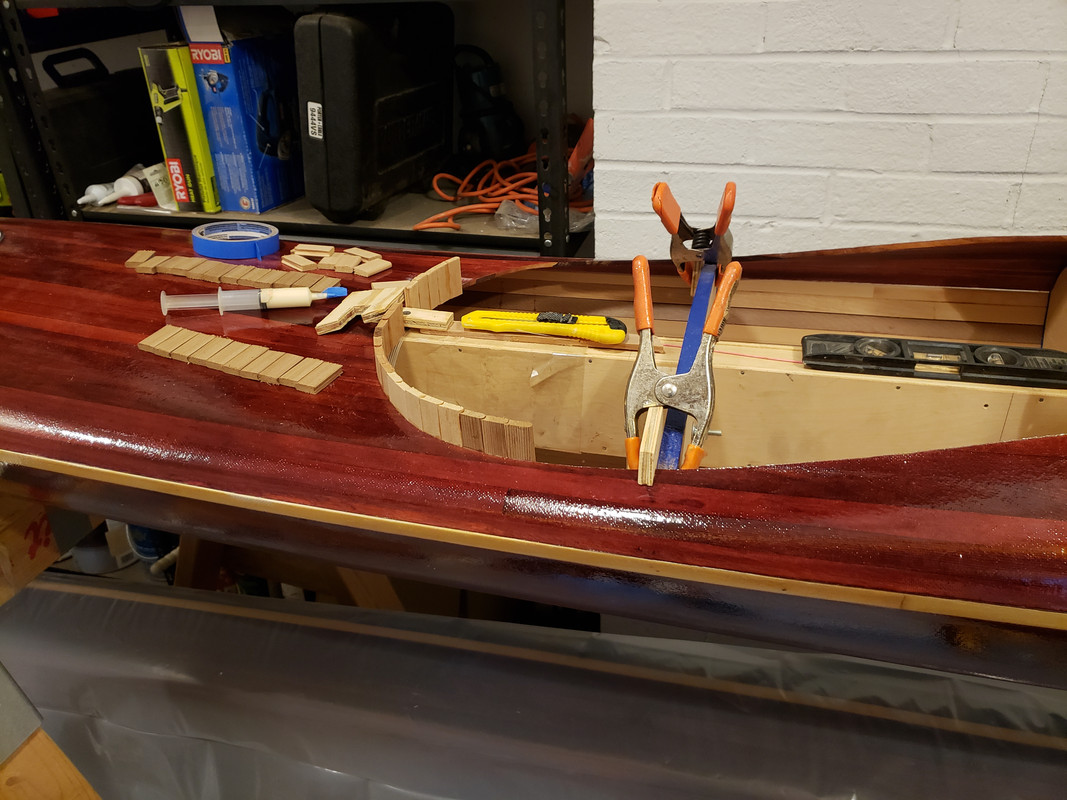

Good advice from Howard above. From the "multiple strips" comment I assume that you are laminating the external stem from multiple strips? If so, that is quite easy to do after the deck and hull are joined and the entire boat is glassed. This sequence shows installation of the bow stem on my Mystery. Technically, it is a redo because the original was very vertical and caught every weed it came close to, so I planed most of it off and started over.
I used 1/8" strips of Alaskan Yellow Cedar. I found them very easy to bend into shape with a heat gun after soaking in a bucket of water for 20 minutes
