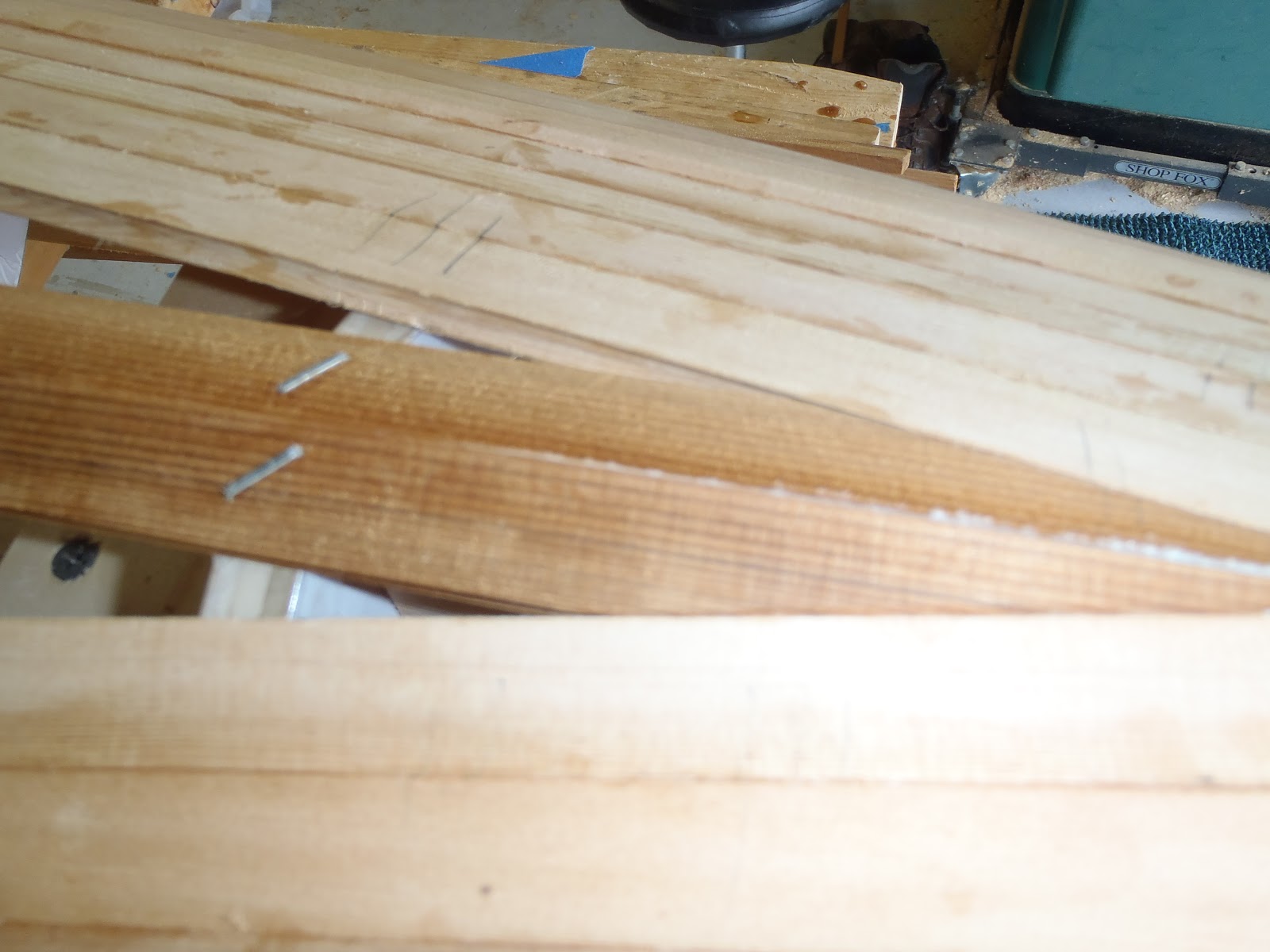

Here's several pics to help you see the herringbone pattern, and the side strips that is opened to coves.
http://3.bp.blogspot.com/-zxQog83aygM/UJ0OGAPQR-I/AAAAAAAABQE/j98KNZ7-rNg/s1600/P7110439.JPG
http://4.bp.blogspot.com/-SFELGlqKAs4/UJ0E-vRgf2I/AAAAAAAABNU/vunwFHfCews/s1600/P6220399.JPG
This shows how to fit the strip.  Since to are fitting the beaded strip into a cove, some of it is hidden, so I put the strip to cut up to the opening an mark the cut.  I then plane to fit.  Once the strip is dry fitted, I put register marks on the strips to fit them exactly after I apply glue.
http://1.bp.blogspot.com/-UVouqYqVQ5I/UJz_hNngCOI/AAAAAAAABLk/aTJjTpvEelI/s1600/P6080367.JPG
