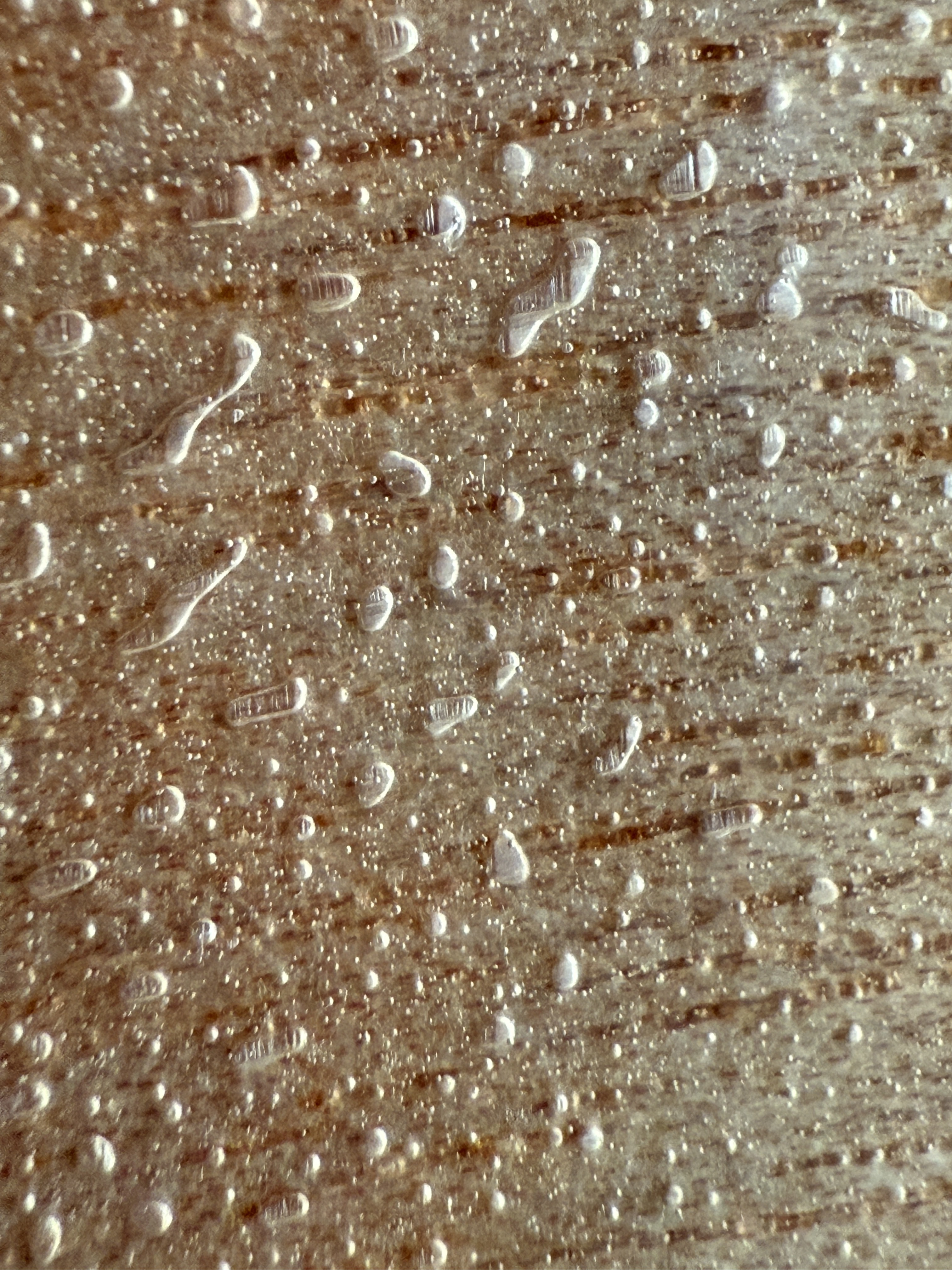

So I’ve made some changes, and we’re getting better. The very small air bubbles are mostly gone. But, we have a new type of bubble now. Here is a very zoomed closeup. The size is something between a poppy seed and sesame seed. What I had before was more like poppy seed or smaller.
Any ideas on what I might be doing that leads to this? For now I just sand it out and cover the area with another layer of epoxy but this is a pain.

Are those bubbles or beads? That is, are they hollow or solid? To my eye there’s a very strong resemblance to water beading on a well-waxed car.

Im pretty certain at this point that it’s outgassing. I’m running some tests with different heating cycles to prove it, but optimizing the heat seems to be slowly improving things. Let’s see.
