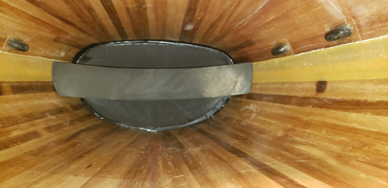

below is a picture from the cockpit of my 'foam foot-peg' on the petrel.  in this case, the forward bulkhead is also foam (3 inch thick minicell glued in with 5200 adhesive).  on my frej, the forward bulkhead happens to be wood.   so far, this system had worked well and proven very strong and light and i have been able to craft the boat to adjust to the few people i allow to use them.
