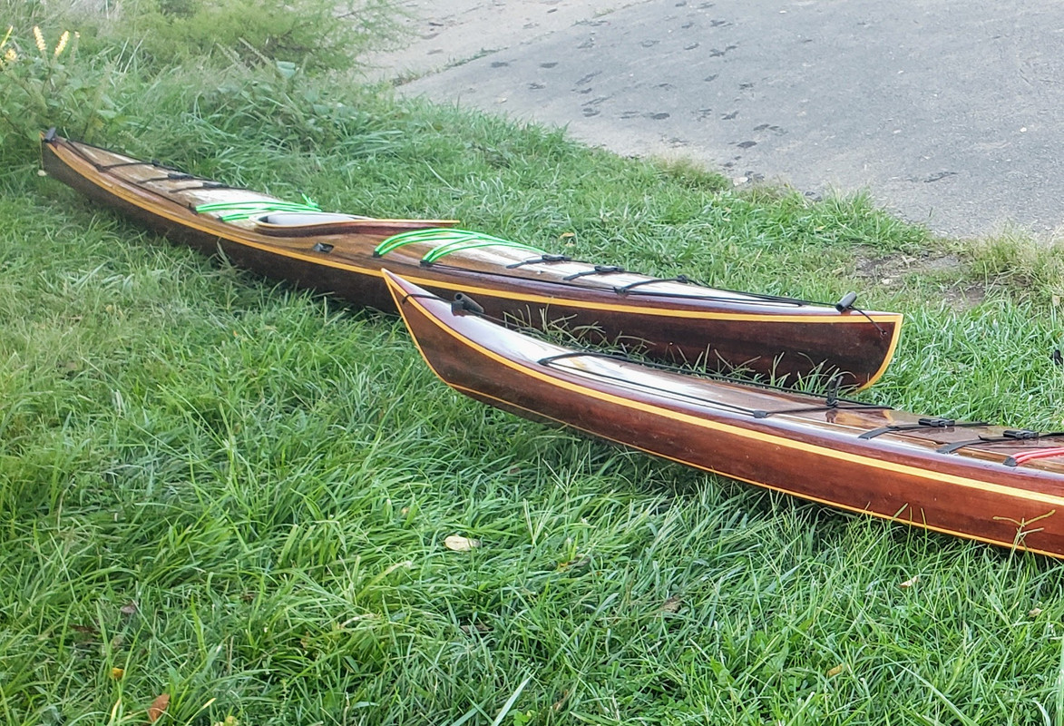

ps...for inspiration, two of my strip builds after an afternoon paddle with my daughter.  both of these were built with only 3/16 thick cedar....and used the techiniques described above...so i have a lot of experience with this type of construction.
