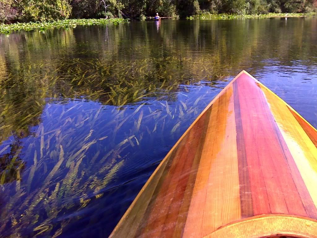

The benefit we found with ripped quarter sawn is the grain is exposed as a 'face' more than a line. Hard to describe, the rip exposes wood paralell to the growth rings as compared to ripping flat sawn lumber for a perpendicular or diagonal exposure of grain. Our quarter sawn material was a light mahogany and when ripped exposed wide grain with little 'flecks' of sparkles. Very pretty but hard to describe well. You may have to copy/paste this link, click on the photo to enlarge it. The top three strips are 1 1/8 ripped quarter sawn mahogany. You can compare it to the light and dark cedar strips next to it which are ripped from flat sawn lumber.
No difference in bending shaping the different cuts or material, ezpz. The white oak is a different story though, it was a chore.

Got it! Thr grain does look great!
Where was the picture taken? Was it Ichetucknee Springs in Florida. Well I guess it could be any spring system in Florida. Maidened my first home built kayak there( Ichetucknee Springs s ) 35 years ago.

TLAR, sorry I forgot to answer your question. The pic was taken at Alexander Springs, sort or east central area of FL. Here's a link to the trip: Alexander Springs Warning though - if it's been 35 years for you this may tug on the heartstrings a bit...
I grew up in Ocala and Alexander Springs was my favorite. Did a lot of snorkling there. Taught my wife to snorkle there also. Thanks for the memory trip. Too many of my "great places" have been ruined by developement. My bucket list contains a trip to all of my great places such as Alexander which is why I am building my Yak.
