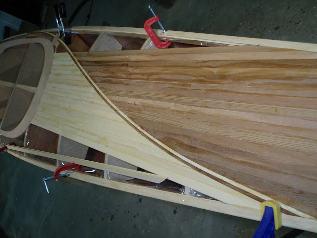

I spoke with one of the Matts in Groton yesterday about the best way to do the curved strips. He suggested an iron or laundry steamer. Any other thoughts?
Hey Dan,
I told you that building yaks was habit forming, one can always come up with an excuse to build another.
If you look close, the curved lines are thinner than the rest and will do a gentle bend with no problem.  Remember all the curved lines my first 2 yaks had?  I find that curved lines in the pattern are easier than straight ones.
http://kayakkev.wordpress.com/2009/04/16/guillemot-l-part-4-in-the-water/?preview=true&preview_id=511&preview_nonce=dfa3e91a2f
http://kayakkev.wordpress.com/2008/11/09/my-first-wood-strip-kayak/?preview=true&preview_id=12&preview_nonce=a77dc5b27e
Kev

Excellent advice.
I have a couple of heat guns. I spent 10 years stripping the paint off the beveled cedar siding on my house with a heat gun and a putty knife, but that's another story.

Dan,
Rob Macks, whom you met yesterday, has an online tutorial that recommends using a heat gun to bend strips. Check it out at http://www.laughingloon.com/shop.tips.html

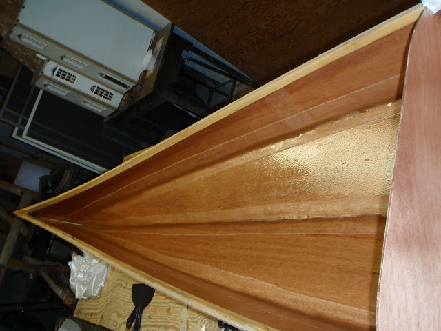

I got the compartments filleted and glass taped and the cockpit glassed this weekend. One thing I'm noticing that didn't seem to be an issue on the last boat is that where I epoxy the plywood with no 'glass the grain is rising. I'm debating whether I should give it a light sanding and another thin coat of epoxy. I know it won't be seem in the compartments but it is kind of rough.
Any opinions?
Dan,
I always do a light sanding in the hull followed by a thin coat of epoxy, rolled on. Makes for a nice, easy to wipe dry hull. And the few ounces of weight it adds are negligible in the long run.
George K
Thanks George.
That's what I was thinking. I'll probably do another thin coat over the glass cloth in the cockpit too. I didn't do this on my boat, but wish I had.
btw, epoxying when it's 70-75 degrees is a whole different experience than doing it at 60-65. A bit more nerve wracking , but it sure sets up faster.

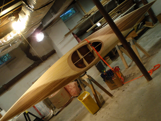

Here's the latest picture...
and another...
Dan:
Beautiful job, and fast.
I think I have to get going on my second.
Congrats, lookin GREAT !
Ted B
Thanks Ted,
The second one is definitely going faster. I'm not second guessing myself the whole time. This deck pattern means I have twice as many strips to fit, but I have the routine down pretty well and it's moving right along.
I'm not promising my wife that it'll be done this season, but you never know.
